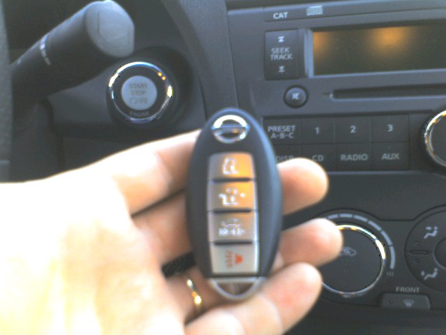

Now aside from the pure, unadulterated, jealousy that these ads evoke, as I’ve yet to wake Christmas morning to such a display of affection and extravagance, I have to ask, “Who really gets/gives a new car as a holiday present?” Well, this year I can bear witness first hand to just such an event. My mother-in-law was the gleeful recipient of a new Nissan Altima, a very fine present indeed. But what makes this event noteworthy was what happened next, as Donell entered her car for the first time and prepared to rev its engine to life she made a shocking discovery, there was no ignition key. It was then that her husband handed her a small stick of buttons and explained that this device was the “key” and that as long as it was within a couple of feet of the steering wheel the car would start with push of a switch!
So how does this work? What is the magic of this transmitter, can I now jack cars left and right with a Bluetooth headset?
Nissan Describes this marvelous break-thru as: Intelligent Key with Push-button Ignition“You won’t find this on other cars in the class: Intelligent Key with keyless push-button ignition, which comes standard on every Altima. All you have to do is push the button on the dash, which signals the standard Intelligent Key in your pocket or purse to start the car, and you’re off.”
На картинке некий ключик с какими-то кнопочками. на фоне рулевой колонки и местом для нажатия :)
